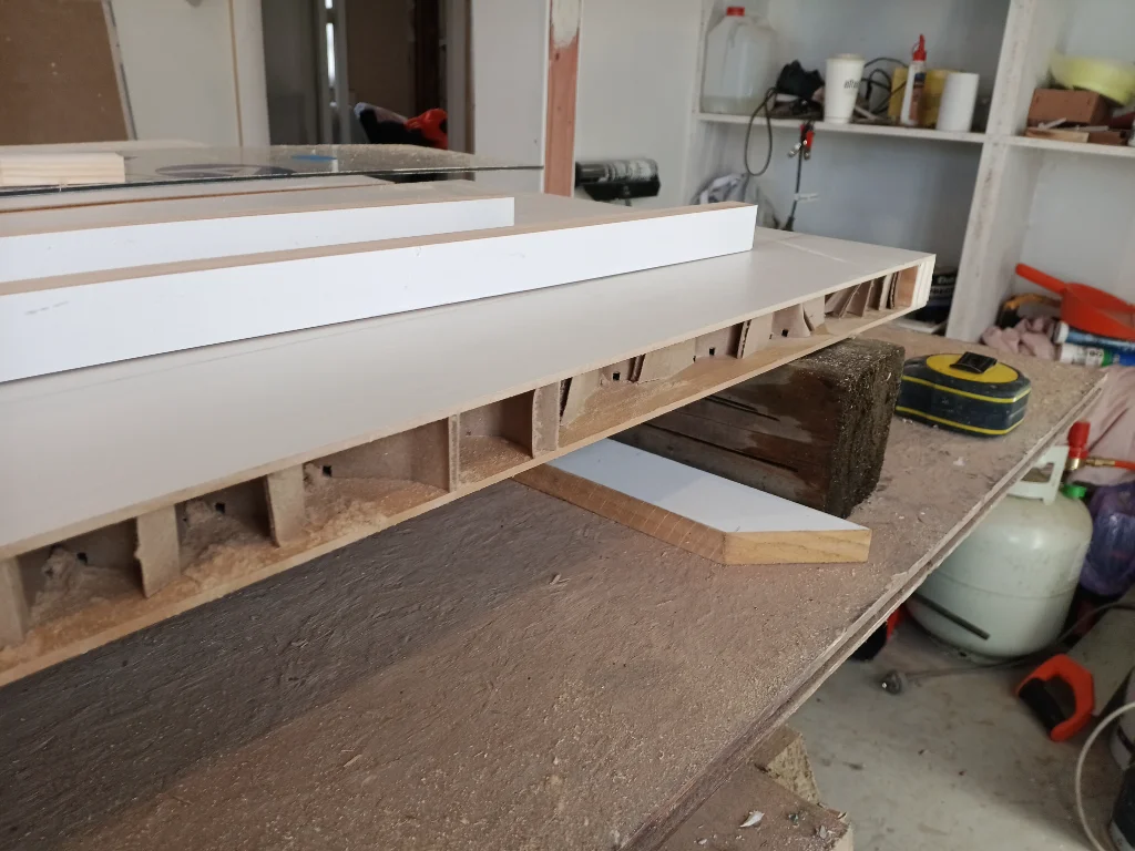

Think I've mentioned before about the cost of doors in the style we want , it's crazy. The wardrobe doors would cost $98 a piece for a 450mm door with the vertical grooves in em but $57.00 for a 900 blank. So I got 2 blanks, cut em and routed the grooves in.
They are hollow core doors so when I cut em in half I had to take out a bit of the honeycomb interior and glue and pin a bit of timber in there. Piece of piss..
Took 3 hours to do that and router the grooves in to those and a solid core door for the lobby. Doing it this way saved us just over $400 all up.
I've done shit like this on site with a skillsaw and planner many times but doing it at home with a table saw and thicknesser was so much better!

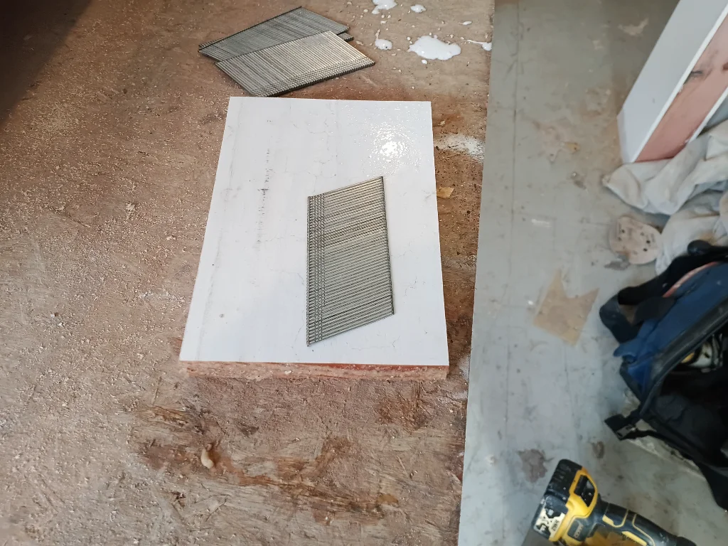

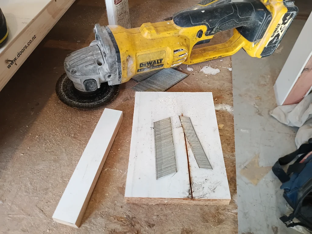

Ya can see in the pics how a went about it, probably common knowledge for those that do thus stuff but a good tip for those who dabble a Lil is, if ya don't have the correct length pins for ya pin gun, you can cut em down with a grinder. Hold a block of timber on em for a guide and to ensure the don't come apart and remember to buz over the ends on an angle to remove the burring or they will jamb in the gun..think the smallest you can cut em down to is 20mm before the won't work in a paslode pin gun...

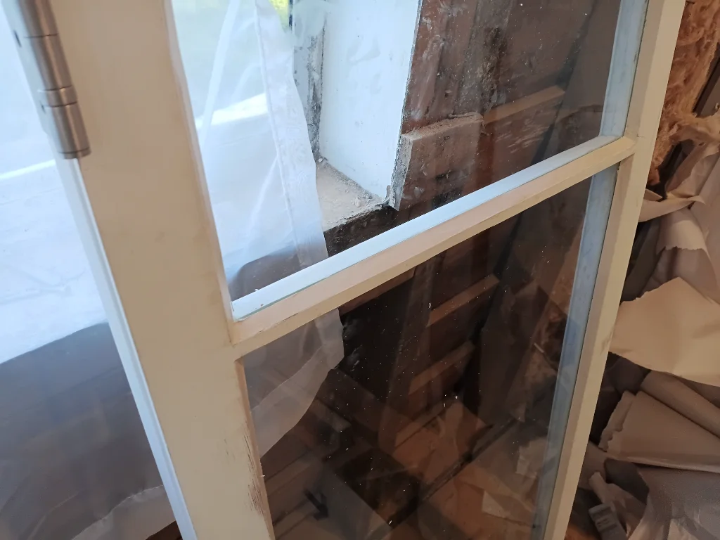

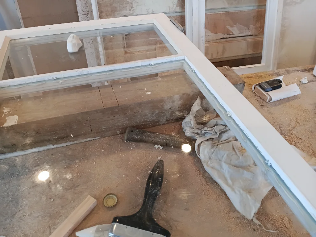

Also yesterday after work, I started glazing the windows. Shit job, i struggle to get what i think is a good finish on the putty but most of that is cause I'm fussy, truth be known, I've painted hundreds of windows and my glazing is better than most I've seen, that said, most were shit so that ain't saying much.
Anyhu, they have come up acceptable, I'm just slow at it and hate the job... I've done 4 and will do the last 2 on this set of windows when I'm done with the wood chipper...

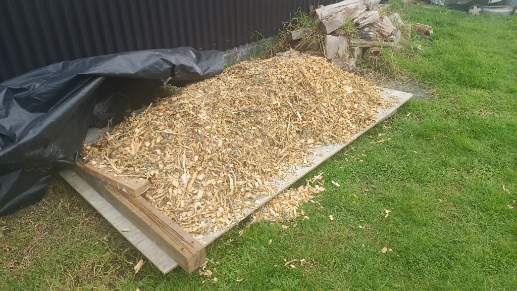

Came out with about 3/4 of a cube of apple chip and maybe a 5th of cube of apple peach and quince combo. This willbe used for smoking as ive enough of the apple for the chicken coop and ya can't use peach chip with chickens apparently but ya can for smoking.. anyhu, just gotta dry it all now.
Gunna hang the mix in shadecloth in the lean to ( when my mate come to help me lift it) and the apple is on a sheet of ply.
Apparently if you cover with plasticity will naturally heat up and if you put a few holes in the top, the moisture will escape. We shall try this and if it don't work I'll come up with something else....

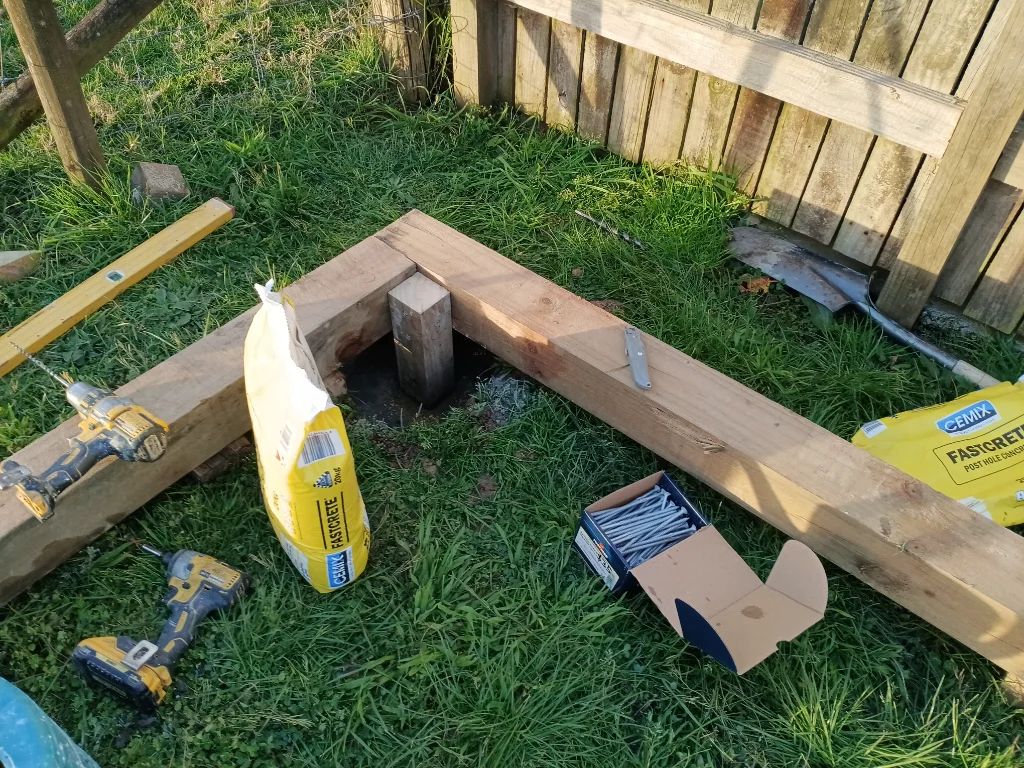

So my B is away this weekend to see her dad. I've enough on my plate trying to get the house done but she has been banging on about keeping chickens for since we moved in, so, to cheer her up , I'm building the fucken chicken coop and run as a surprise.
Tbh I like the idea as eggs are like a doller each these days and chickens manufacture eggs for fuck all....
So today I bought the bulk of the materials to build said set up.. $750 nz pasos !!! And that's not even all we need!!!!!! I've done the math and these fuckers need to produce and egg a day each for the next 3 years just to break even!!!!
OK, it could be done vastly cheaper but I'm not looking at a fucken ramshackle eyesore every fucken day till it falls over or I die so I'm doing it my way ..
Anyhu, after work and shopping for the shit required, I got home at about 3 30 and have just stopped as it's dark now.
Our yard is a bit of a swamp at times so the idea is build up a base well above the water table. So I got some 150 x 150 sleepers and have planted em on 100 x 100 Lil posts concreted in and will fill 100mm with top soil and the rest with the apple tree chippings.
