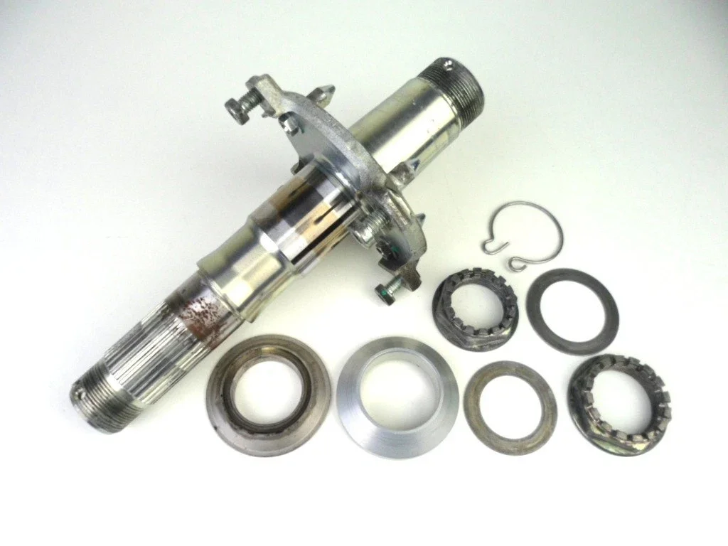

I pulled the sprocket setup apart to investigate. Visually, the splines on both the steel axle and the aluminum sprocket carrier look 100% fine. However, when I slide the bare sprocket carrier onto the axle splines by hand (with the 41mm nut off), there is a very small amount of rotational play / backlash when I twist it back and forth. Once torqued, the play disappears, but after a short ride, the 41mm nut works itself loose.

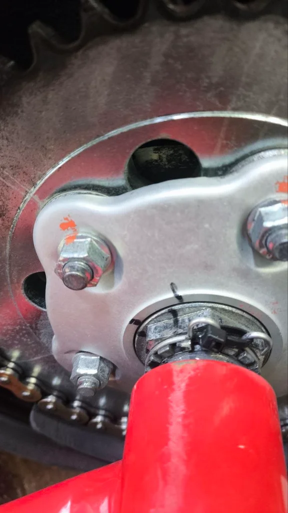

of what exactly? there isn't much to see... tighten everything to spec> paint the nut> ride 200km hard> the paint shows the nut backed off a tiny bit
(ofc it won't bag off entirely because of the sager, but enough to break the clamping force...)
would post a video of the assembly off but i already re installed everything

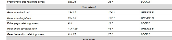

i tried torquing a bit higher, 170 instead of 156, went for a 5 min ride, crancked the throotle at low rpm and high rpm and did a few hard breakings....
Loosened in 5km...
The only thing I can come up with is that the torque wrench has been left tightened up for a long period and lost its calibration and or the wire clip is not locating in the axle hole.
Can you see the wire clip protruding through the axle?

The castellations in the nut should form a “vernier” location for the clip… only one castellation will line up exactly with the hole in the axle, allowing the longer straight end of the clip to locate and stop the nut moving.
After torquing up check where this is and secure the clip. A zip tie is definitely not needed if the clip is correct and not bent.
The castellations in the nut should form a “vernier” location for the clip… only one castellation will line up exactly with the hole in the axle, allowing the end to locate and stop the nut moving.
My KTM 1290 Superduke had three circlip holes on the axle stub while the circlip onl had two tips. Depending on which torque wrench you used they wouldn't necessarily line up the same every time. It was a PITA.
