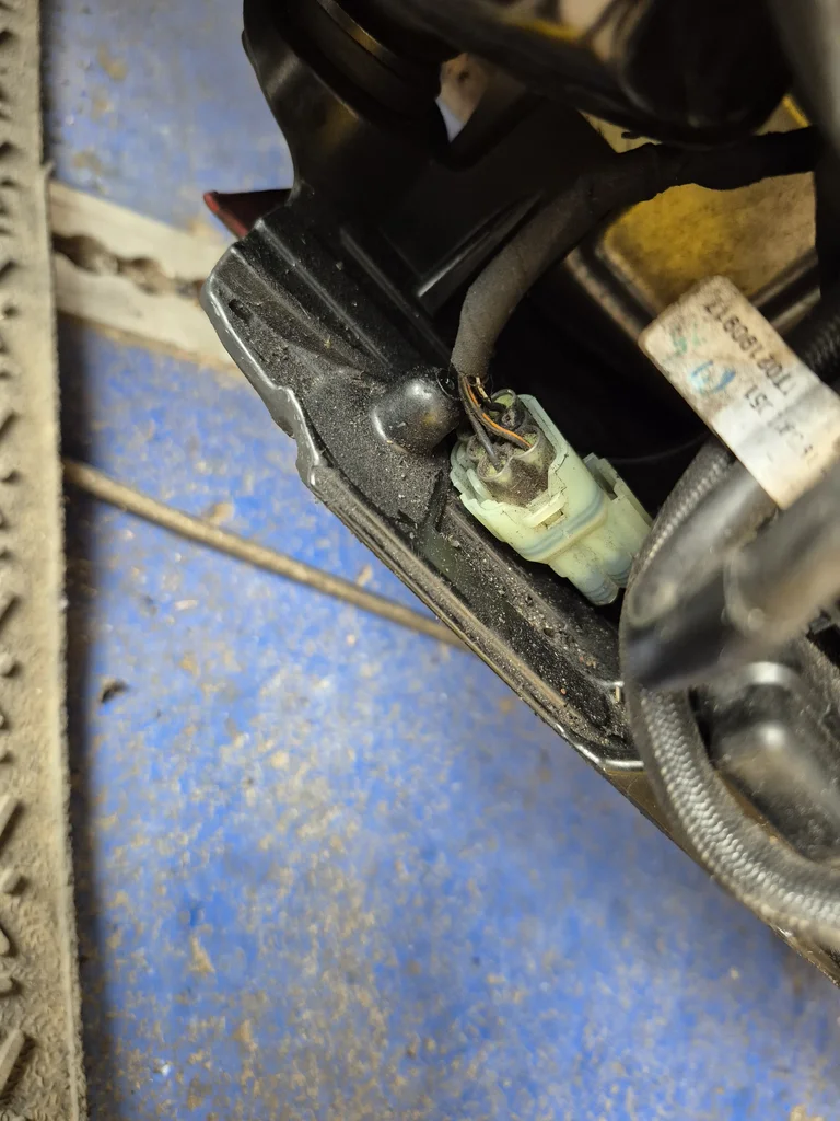

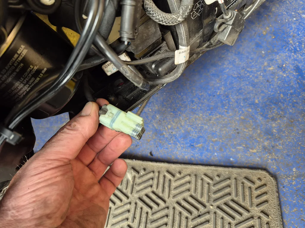

Think I've confirmed the problem. Disconnected the little cable to the right hand switch block, blew out everything with an airline, blasted with contact cleaner and blew out again. Clean. Squirted the block with water dispersant, blew out and applied the contact cleaner again. That made everything worse. Right hand backlights still on when ignition off, woke up and fired just fine but engine died within seconds rather t6han the few minutes before. The more I tried the quicker it died.
Took off side panel and checked the battery. Dusty in there but no corrosion and terminals greased. Tested the battery and it was tip-top. Resting voltage 12.8-12.9v. Cranking voltage a very robust 10.8v. Nothing wrong with that. And I set the meter range to 20v so it should have been pretty accurate.
Then I noticed that after turning off the ignition at the main switch it was turning itself back on again by itself. Pulled the little block connector out of the right hand switch block and it stopped doing that. It's definitely the right hand handlebar switch block. Will ring around for best price, including @Nelly and get one bought and fitted.
Lesson: right hand switch blocks on canbus Ducatis, including the very latest V4 Multis, Panis, Diavels and SFs are VERY sensitive to water damage. Wet it, you fuck it. So don't.
