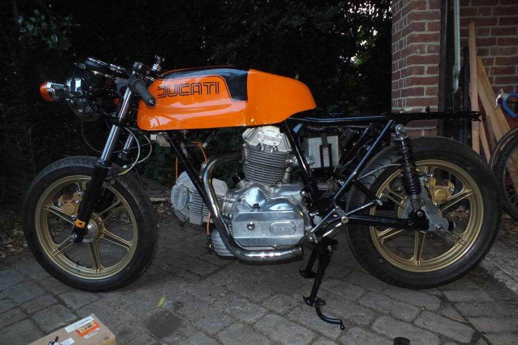

I have woken up to Spring and started tackling the remaining works prior to reassembly of the old girl.
I went to see Russell and progressed my swinging arm mounting points; I need new ally blocks to support the SS spindle diameter which is slightly larger than the GTS spindle. The blocks will have the hole in the centre as opposed to eccentric as the Metmachex swinging arm already has really neat eccentric adjusters at the wheel spindle.
I can't reassemble the bike without these so they are critical path if I want to be at the Horsham Piazza run on the GTS - and leave the SS sulking in the garage. I used the SS to get to a meeting today, it was a b*gger to start and I wish I hadn't bothered, Paul Klatkiewicz, proprietor of Ducati Technical Services said don't wring it's neck until it is thoroughly warmed through - which takes 10 miles apparently. So I dutifully rode 10 miles at running in speeds and... guess how far it was to my destination? Yup, 10 miles. FX: Ooops. What was the point?
Anyway, today I have ordered:-
  • the FS1E Candy gold paint :D (3 litre kit 269.99+VAT+delivery=£335.69 GBP - FX: Choke! :sick:)
  • side panel decals for the 900GTS from the most excellent Classic Transfers
It's a start.
One more thing, looks like Öhlins DU 140 shocks are not easily available in the UK ATM, so shucks! I guess I'll have to settle on my Fontana's for the GTS and I won't have to shell out £750 for shiny new Öhlins; What a blow! I think my wife will be pleased.

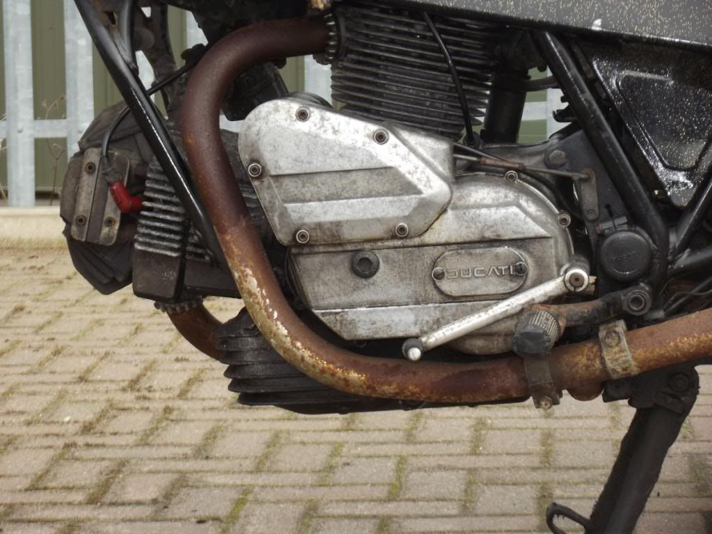

1/ Hmmm not sure i agree with Klatkiewicz. I might agree on a plain bearing engine but a roller bearing engine ?
2/ If its a bugger to start its not set up right. It should start through will power almost.
Compression seems good, might need shimming after nearly 1,800 miles. Could be something to do with 35 year old ignition components. It hasn't done it for a while , it has been an easy starter but I did have to lube the ignition switch the other day; Might need a dismantle & contact clean.
It shouldn't need shimming for years. when i saw it you started it first kick. I suspect its something peripheral as you say, switch contact or pilot jet dropped off into the float bowl.... something silly .;)
How long did it sit since it was last run? With modern unleaded, any fuel left in the float bowls will evaporate and can gum up the pilot jets. I always recommend turning off the taps and running the engine until the carbs are dry any time that a bike is going to be sitting for more than a week or two.
This is my SS and I have been using it a lot to complete running in before Spring. It used to be a right PITA at starting especially just after the rebuild, but it has really settled down since then and has been a doddle to start - until I had a meeting appointment yesterday and I ended up bumping it.
I am seriously tempted to stick a Silent Hektic ignition in it; It is running a nearly new run in engine with nearly new carbs; Apart from a service/shim there isn't too much else I can fiddle with/replace apart from the 34 year old electronics.
Edit: I didn't see your post, Derek. I wouldn't remove it from the GTS - I'd buy another. I was hoping to keep the SS largely standard, I do have spare coils & transducers so I might give those a shot first.
See what the spark is like, a good indication is how far it will jump. Dont discount shorting plugs either, Modern fuel can kill the insulation.
My Audi simply kills Bosch plugs in 1000 miles and will only run on NGK.....and Audi fit Bosch as std :)l
Spring has sprung...

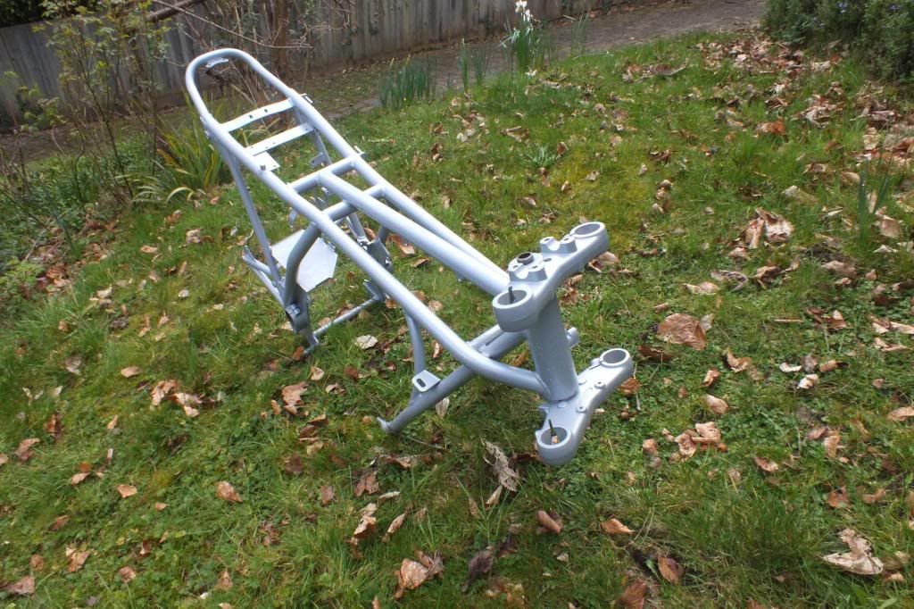

At least, we have passed the equinox even if it's still a bit nippy. Derek has blown me into the weeds so I am now quietly truckin' along. The metalwork is in for spraying with Tony at Cycleworks. It turns out Tony did some paintwork for me about twenty five years ago, all good with no mistakes or whinging as I experienced with the guy who did my SS. I was tempted to go back to the guy who did the SS but it would have been like saying 'Hey, I know you treated me like crap last time but no worries!'. I just couldn't.
Anyway, I am expecting a spectacular job on time, on budget without any mistakes and by the way, he is significantly less expensive. I guess that old saying about getting what you pay for holds true; I am getting less whinging so it will cost less.
I got started yesterday on the build, starting with fitting the yokes; My wife noticed and announced 'I see you have got yourself another Italian mistress'; Fortunately no further questioning ensued or I'd be done.
That all went well and the steering feels very smooth with its nice new bearings. The eagle eyed may have noticed it is a sort of metallic grey, generously called silver by the suppliers. Grey, then ;-)

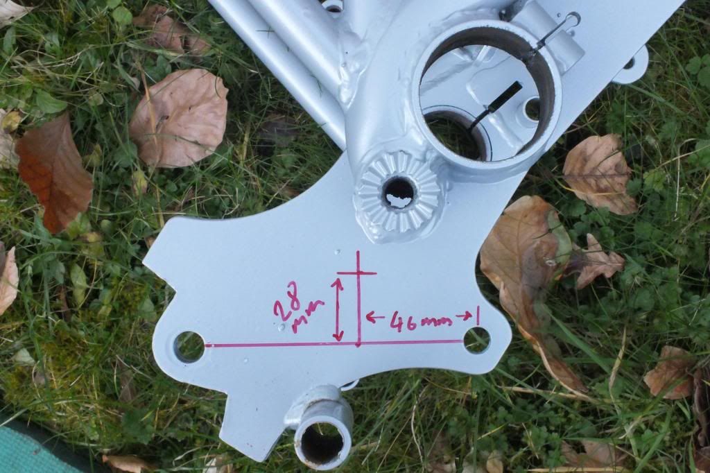

Here the frame is marked up...
and drilled, tapped and fitted...

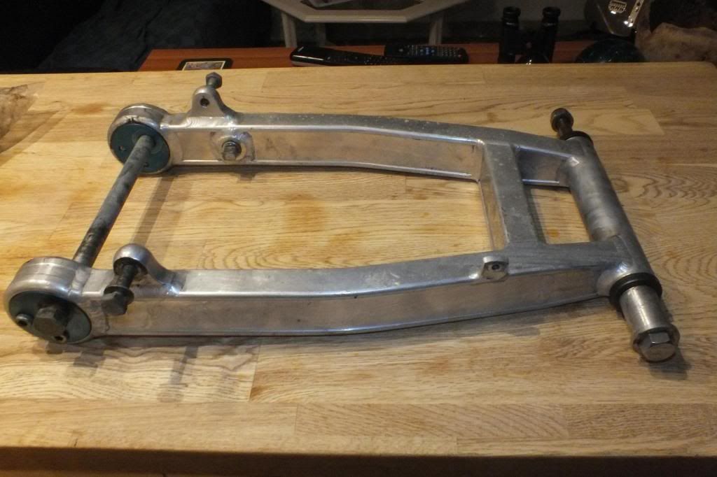

The Metmachex swinging arm going on the bike looks like this...
The swinging arm allows the use of wider tyres - which really doesn't bother me at all. It does have much neater eccentric chain adjusters than the originals, the subject of which is another post.

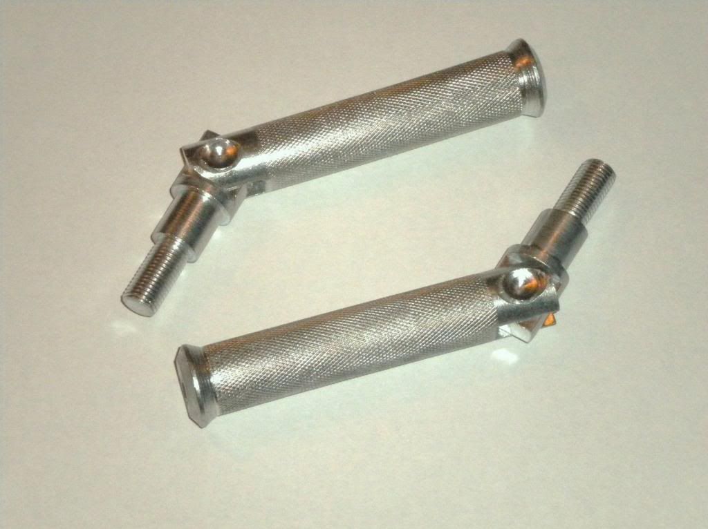

I bought a set of these, mistakenly believing they had 12mm thread when in fact they are 7/16" UNF. In my defense I don't remember them being so well marked :embarassed:.
So I welded 7/16 UNF lugs onto my GTS frame...
It doesn't matter what the footrests are as long as you have a friendly welder, necessity is the mother of invention ;).
Ducati footrest threads are a law unto themselves. Yes looks like a bit of welding needed, i just wondered if any one made a bolt on set ? its not something i have ever come across, everything except Darmah.
Brake master cylinder, lefty gear change i suspect ?
Yes indeedy, if you look at the ally swinging arm above it is a disk brake swinging arm.
It's why I need to machine up a couple of spigots to fit the eccentrics.
I made three changes to the frame:-
  1. added rearset mounting points
  2. added rear master cyclinder mounting points
  3. added a rear mounting point for a RH side stand handle to match the LH side. I thought they make great bungee mounting points for my planned trips.
I also repaired the front seat mounting point which had abandoned ship at some point.

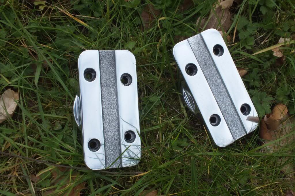

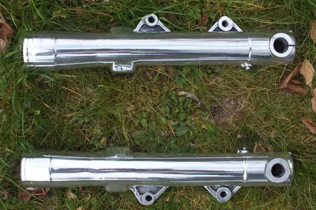

I picked up a few bits from Angelo who runs A M Metal Polishing in Cowfold. See for yourself the lovely quality of his work. He charged me £60 for polishing every alloy piece you see.
And individually, the fork lowers, these were heavily crazed even though I had already machine polished them; Angelo reckons a/ they were left out a long time (true) and b/ they are porous (almost certainly true) which means they were heavily & deeply corroded.
Before...
and after...
Cam bearing support castings, before...
and after...
Pattern alternator cover from MDina, which is a nice bit of ally but comes rough cast, here it is done...
If you like any of this, here is how to find the man. Please let him know how you found him.
